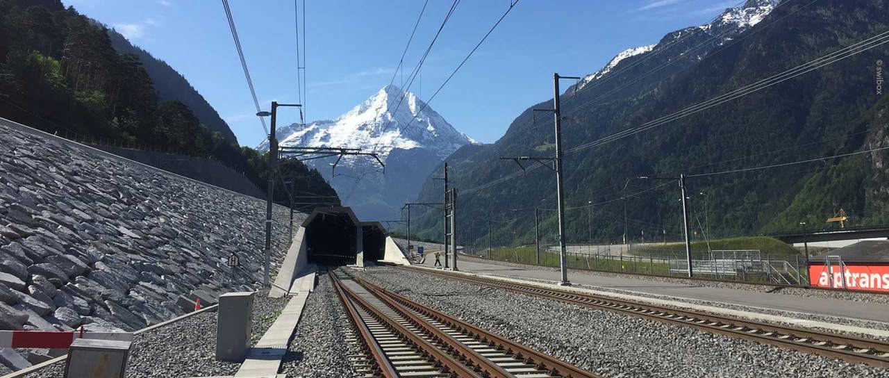

The pressure-tight control cabinets in the cross passages and technical niches of the Alptransit Ceneri railway tunnel protect the electrical control equipment and crucial safety and radio technologies from dirt, moisture and heat. The cabinets are sealed with Roxtec cable transits.

The safety standards for the construction and operation of railway tunnels are particularly strict. In the new transalpine rail link, with base tunnels at Gotthard and Ceneri in Switzerland, the demands are significantly high. Since passenger and freight trains pass through the Ceneri tunnel at 250 km/h, all components used must withstand enormous pressure and suction loads. In addition, there are considerable temperature differences, high humidity and extreme dust loads.
